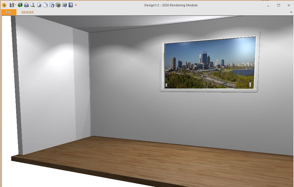

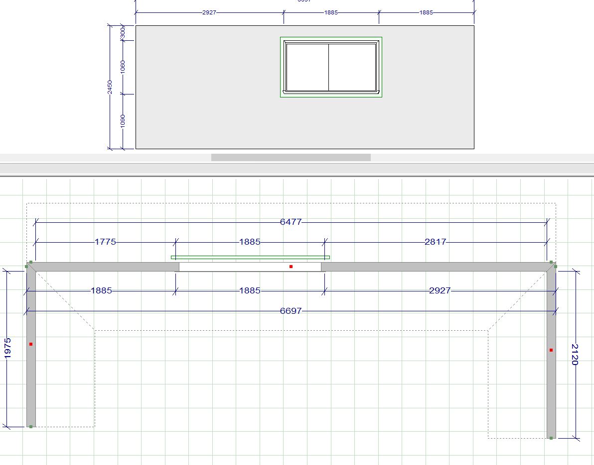

      I didn’t have a problem? I used a PVC White Sliding window from ROOM_M and changed the glass texture to clear glass. I then used a picture frame on the outside with the picture I wanted and used an external placement zone and elevation to move and size it.

      I’ve used the surface tool on a wall beyond the window and manipulated the size of the “texture” downloaded in order to get a different background.
      I realize that’s more complicated than what others want to do, but I’ve been able to get some unique backgrounds that way.
