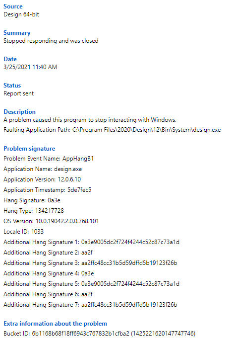

ParticipantI tried all above suggestions, Problem persists … attached info is what i get from security and maintenance log.
Also only time that i can get it to work is when i use 2020 maintenance software and clear the registry. It works about 3-5 mins and it crashes again when i hit rendering.Attachments:

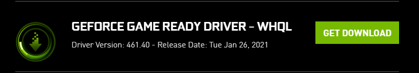

This is extremely unusual behaviour – can you not flip to the Redway engine rather than the Live one?When it comes to drivers, if I have trouble (rare on NVidia) I switch to the Windows Hardware Quality Lab (WHQL) version which usually fixes any issues. In your case, I would suggest V461.40 (see pic).
