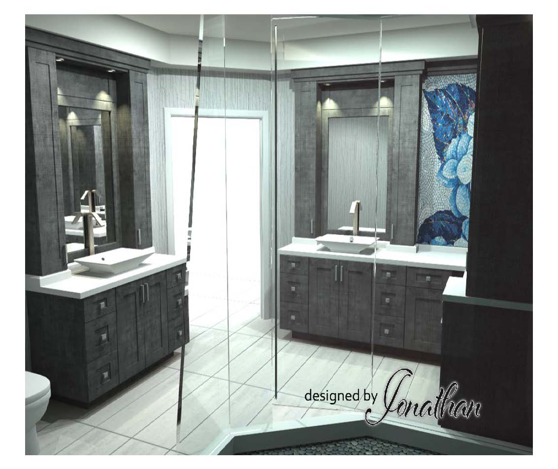

I’ve attached an example of what my renders look like even with the reduced resolution. This one took about 4 minutes in the background while I worked at high resolution with global illumination on, ceiling lighting off and scene lighting off. I placed 4 recessed lights myself and then three strip lights (one cannot be seen in this render as the “men’s side” of the bathroom is cut off.
