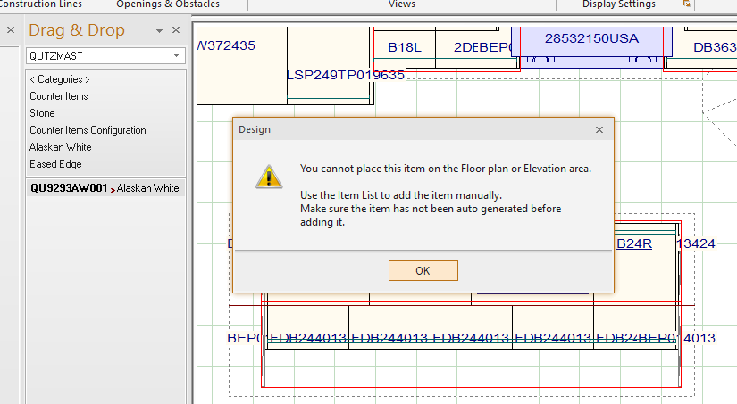

      1. I downloaded the countertop catalog like cambria and QuartzMaster. But I can see that in my drag and drop menu and I can’t apply them. And I read out all of the forum and installed metric and imperial wizard and still doesn’t work.
      I emailed to 2020 center with my captured screen but didn’t get the reply.
      2. How can I use 2020 global style validation?

      The error in your screen shot is because the item you selected from your catalog does not have a 3d shape and is just in the catalog so you can add it to an item list.  For example if you wanted to have an extra length of molding included in the pricing but not showing on the floor plan.  Most catalogs will have 2 entries for items like that.  One that shows on the floorplan and one that does not.  All you need to do is select the one with a shape associated to it.
      Global style validation is a way to set door styles.  It is catalog dependent in that not all manufacturers use it.  It is just a series of screens that allow you to choose your door styles etc…

      To add cambria countertops you need to use the countertop wizard.  You can pull countertops from other catalogs like room or the sample catalogs directly but cambria and others like Silestone need to installed using the Wizard.
      Neil
