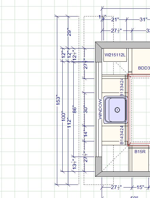

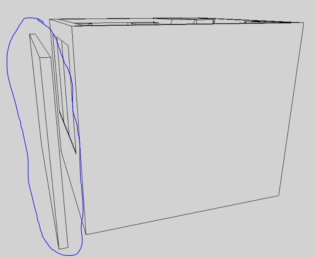

      Hey All,
      I’m new to 2020 and am having an issue with unhiding a wall.  I’m including some screen snips to show what I’m talking about. If anyone has any idea as to how and go back and unhide the wall so I can select and delete it, I’d really appreciate it!

      Hey Angie,
      Thanks for the suggestion, I have tried doing this but I can’t seem to even be able to click on the wall whether it’s right clicking or left clicking.

      Hi,
      I understand what you are saying that you can’t click on it. When that happens to me, I have to make sure nothing else is selected and try again right clicking, and again.
      Since it is a wall by itself, you may be able to “lasso” it or “Select Region” to select just that wall and then delete it. Worse case would be to delete it, then draw it again to put it where you want it.
      Patience usually wins.
